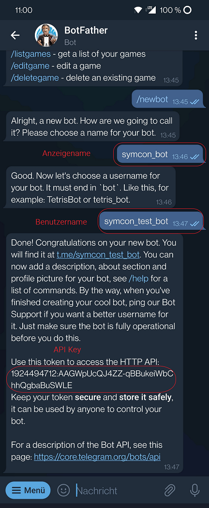

- In the Telegram client, search for BotFather
- Use /newbot to create a new bot
- Under the username the bot can be found and should be populated with for example random numbers

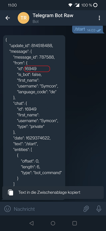

- In the Telegram client search for RawDataBot
- When the bot is contacted, it returns some data, from which you can get your own userID
- This process must be repeated for each user that should be reached by the bot
- Write the bot with /start to start it
