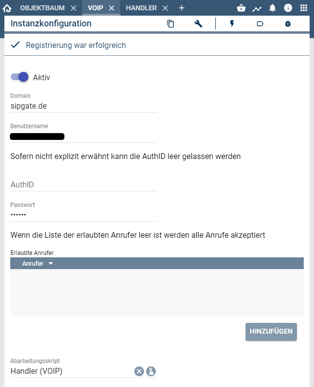

Integration in IP-Symcon
For integration, a "VoIP" device can be added via Add object in the object tree.
Domain and user name for the telephone service must be specified in the instance configuration.
If required, AuthID and password must also be entered.
If the computer has several network cards or -interfaces (e.g. also virtual adapters such as VPN, Docker, Hyper-V) it may be necessary to define the IP address via which the VoIP connection is established. There is also the appropriate special switch "VoIPInterface"

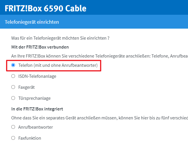

Example setup on the FritzBox
The VoIP module can be used with the help of the FritzBox. A separate unused telephone number in the FritzBox is recommended for this and the following steps must be kept in mind.
If necessary, a new number must be set up under "Telephony" -> "Own number" -> "New number"

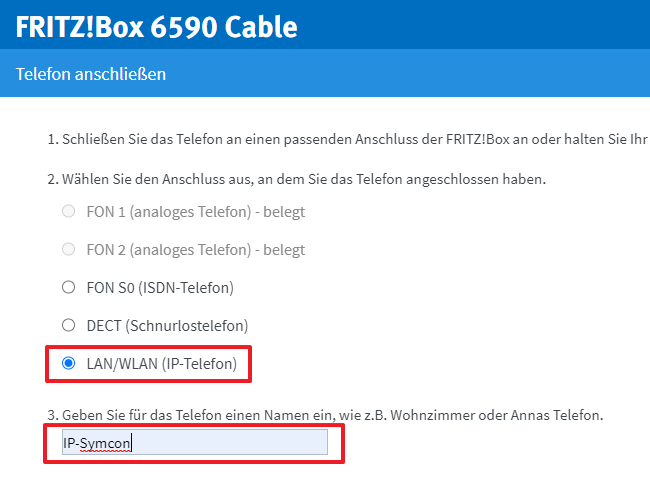

As a first step, a new telephony device must be added to the FritzBox under "Telephony" -> "Telephony Devices".
This must be added as a new "phone".
Add telephony device
Since IP-Symcon acts as an IP telephone, this and then a separate telephone number must be selected. A descriptive name should be chosen for the telephony device.

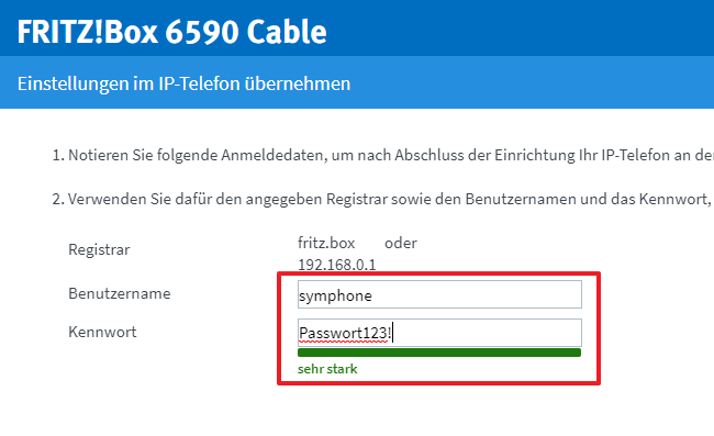

Then a user name and password must be specified, these are later entered into the VoIP in IP-Symcon.
Login data for the VoIP module

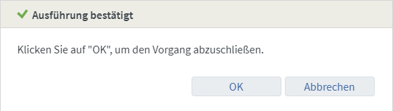

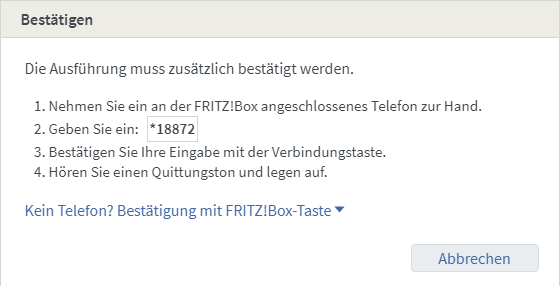

The telephony device to be set up must be confirmed and its setup then completed.
Confirmation
Conclude with OK

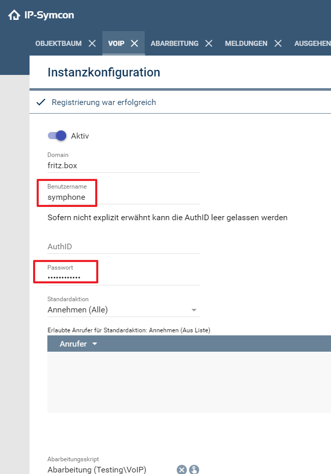

Now the telephony device can be taken over in IP-Symcon within the VoIP module.
If everything went well, the status "Registration was successful" is displayed.
Configure VoIP module

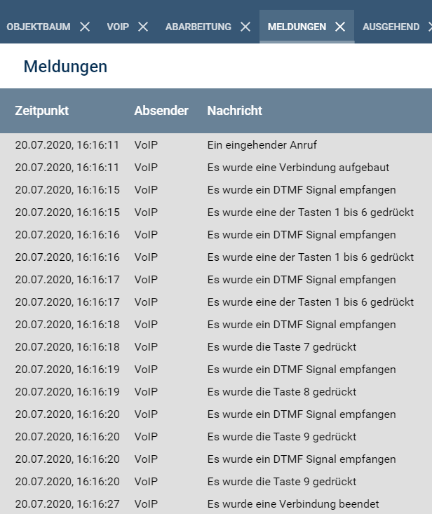

A test call can be made with the Processing-Script set up. In the Messages the following messages should appear when the number keys on the phone are pressed.
Example of messages
