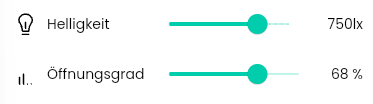

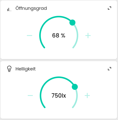

Appearance in visualization tile
As own tile
Within a list
Appearance in the WebFront
The WebFront differentiates according to the display type and has a separate display for each case:
Display type "Absolute"
Display type "Percentage"
