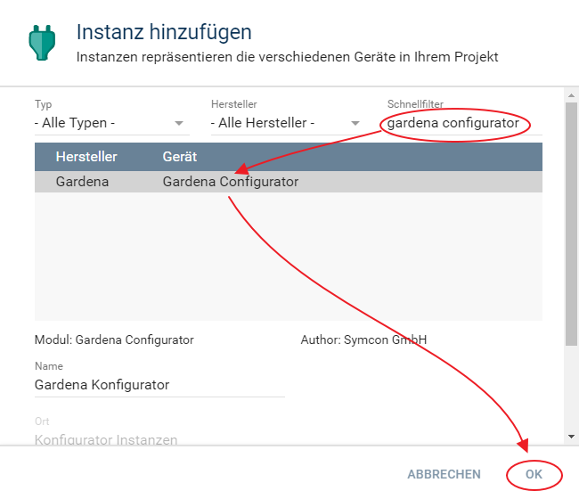

The smart Water Control offers various services in IP-Symcon, which make it possible, for example, to recognize the status of the device or to switch the valve.

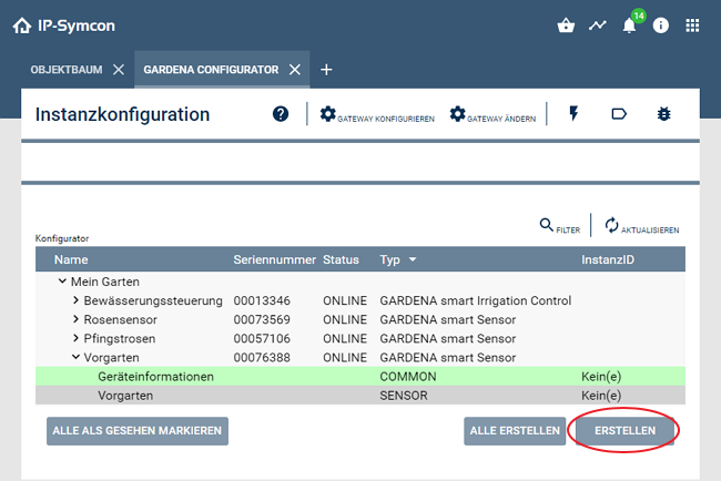

An instance can be created for each service with the configurator.
In the instance configuration, the 'Show last transmitted' switch can be activated to create a variable for each value, if available, that contains the time of the last data transfer.
