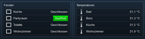

The SplitPane is a layout element that can split two sub-elements horizontally or vertically. In this way it is possible to display, for example a Content Changer with camera views next to a category. As SplitPanes and other layout elements such as other SplitPanes and TabPanes can be inserted below, infinite and individual layout adjustments are possible.
![SplitPane](/media/pages/service/dokumentation/komponenten/webfront-visualisierung/web/editor/seitenteiler/03a561822b-1721983697/webfront-seitenteiler.png)
Subdivision of sub-elements
The "Subdivision" property allows you to set whether the two sub-elements of the SplitPane should be displayed one above the other (horizontal division) or side by side (vertical division). The available space for each sub-element is defined by the properties "Size", "Size unit" and "Ratio Target". "Ratio Target" defines whether the first or second sub-element should be configured via "Size" and "Size unit". The target element is then assigned the space specified by the "Size" property in the set "Size unit".
Example
An image with a picture width of 640 pixels should be displayed to the right side of a category. In order to do this, you assign the vertical value to the SplitPane property, set the "Ratio target" to the second element, "Size" to 640, and "Size unit" to pixel. Now create a sub-element of type category and a sub-element of type content changer in the WebFront configurator below the SplitPane. For the sub-elements, the position should be set so that the category Position 0 and the content changer are given Position 1. Now the sub-elements can be configured to display the desired category and image.
