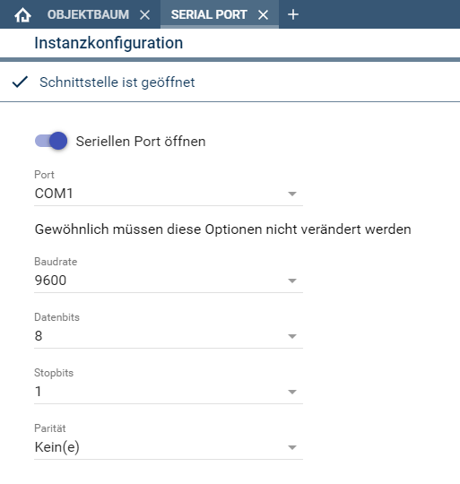

The serial port, to which the device to be controlled is connected, must be specified on the configuration page.
If necessary, the baud rate, data bits, stop bits and parity can be set.
Only a click on "Apply" saves the settings and then an attempt is made to establish the connection.
Configuration page
